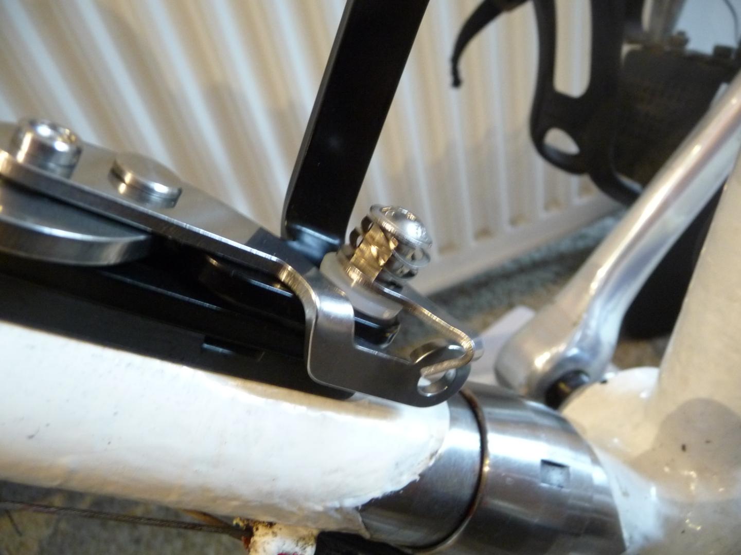

Thanks for all replies. I've fitted Cytronex to my tandem, and used it today for the first time. A bit fiddly to fit but not difficult except for the safety catch mentioned below. Very good in use. I guess that we cycled about 20 miles, I had Cytronex on nearly all the time, although not necessary but just to get the feel of it. I suspect that usually we'd use it only on the hills. Given the use made of it today the battery was showing a red light when we got home. The only issue about fitting it is that I had to remove the "lawyers lugs" on the fork dropouts to get a close fit for the wheel nuts. And there is a safety catch at the bottle holder latch. Any one had any difficulty with getting this right? It's supposed to drop over the latch but I've found this very difficult to do. Thanks again. Charles.

Hi Charles re the safety catch on the cytronex battery...
My battery (bottle shaped) has a slot in the bottom which engages on the bottom of the cage. The top of the bottle is captive on the bottle cage and locks onto the battery by twisting about 30 degrees (sort of a bayonet fitting). It can be a bit stiff to lock / unlock especially with cold hands. I find that sometimes it helps to hold the battery and give it a bit of a wiggle to help the engagement process. Yours might be a different locking mechanism as mine is about 8 years old now. A picture of the battery located in the cage but not locked would help me to understand if it is the same or different.

Thanks Stephen,
Your battery and mine sound to be the same. My Cytronex has a  metal clip at the bottom of the battery holding cage latch which is meant to drop over the cage latch when it's closed and this clip acts as a safety clip. I cannot get this to engage where it should except with what I feel is excessive persuasion. And then it has to be released to remove the battery. I aked Cytronex for advice and they said to check the screws holding the cage were fully tightened with a view to pushing the clip down so as to drop over the cage latch. This I did. The screws tightened a little bit but now will go no tighter. Dropping over isn't possible, force is needed which I don't like to do, although I appreciate the wisdom of a safety clip. I attach a photo of the latch and clip.

As I thought, that is very different from mine. Mine does not have any sort of clip at the bottom of the battery. It relies on the "tail" of the cage locating directly into a slot on the bottom of the battery. All securing is from the bayonet catch where the cables connect at the top of the battery. It is easy to use and very secure but as I said twisting the bayonet catch can be difficult with cold or wet hands.

Charles Smith2025-10-18 19:21:06
Thanks Stephen,
It's interesting that your Cytronex has no clip. After fitting Cytronex and when I looked at the user manual, in some photos no clip was visible and this caused me to think that this clip is perhaps a relatively recent addition. The battery seems to me to be very secure and although it weighs about twice as much as a full water bottle this doesn't seem to be a concern. If Colin and Rosie can comment that would be helpful. Very grateful to you for your input to this.
