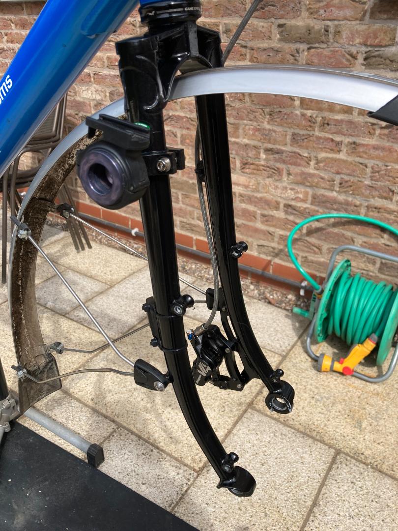

Hi Steve,
see picture of forks.

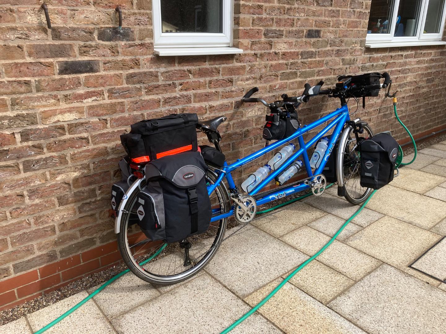

Graham Warr2025-10-19 17:42:09
Fully loaded tandem before we left.
It's an early orbit.  When I bought it from JD they didn't have disc front forks (that's how early)
I'm running hope V4's both ends with 203 vented rotors in both cases.  Moving from HS33 front rim and Magura MT5 with a 203 rotor at the back.  It has been a very significant improvement. I'd be surprised if we ran out of brakes now.
John at JD advised against 220 rotors as he had difficulty with some not running totally true.
